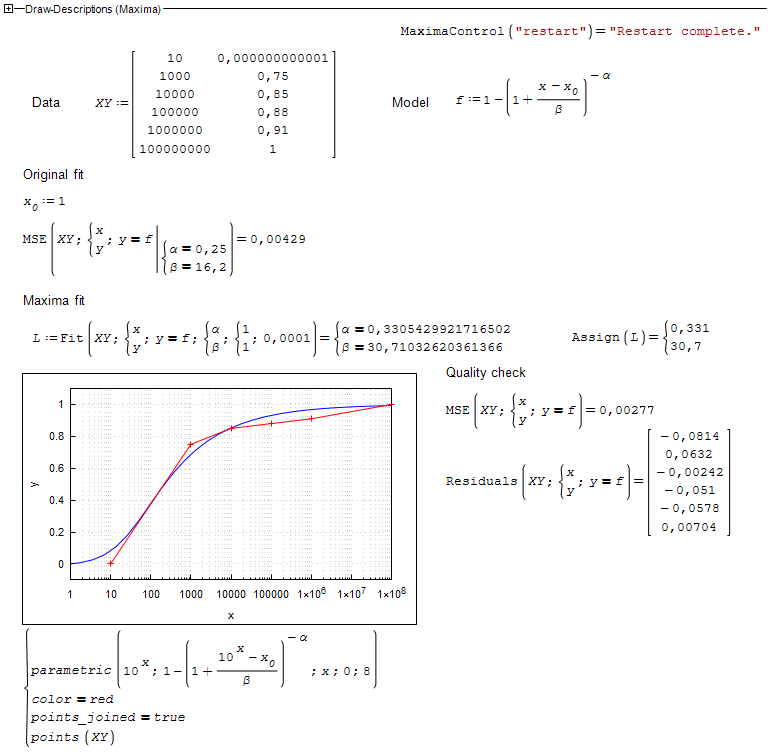

Here is a Maxima version, including the fit procedure. Note the use of parametric() in order to get evenly distributed points in the log plot.
logplot.sm (145 КиБ) скачан 86 раз(а).

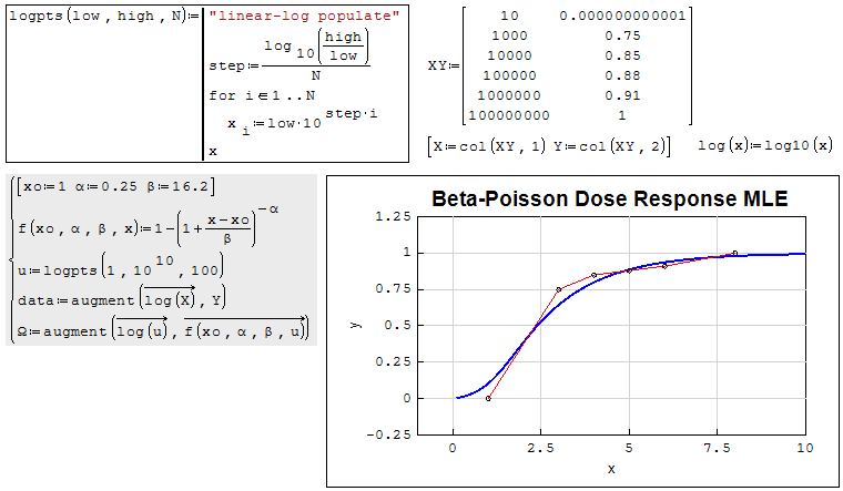

Thanks Martin.
1. added the source experiment notes
2. added Weibull MLE example.
Utilities logpts [Beta_Poisson].sm (353 КиБ) скачан 85 раз(а).
