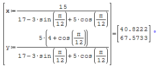

How to turn of the decimal values in trygonometry angles value? I got sth lik this for solution of system of equations:
The file with example: example_v1.sm (8 КиБ) скачан 51 раз(а).

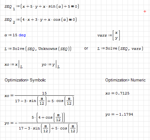

You can use the function al_nlegsolve with any initial
assumptions (because the equations are linear)

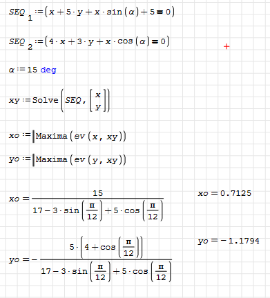

Hi. You also can use Maxima commands, in this case ev():

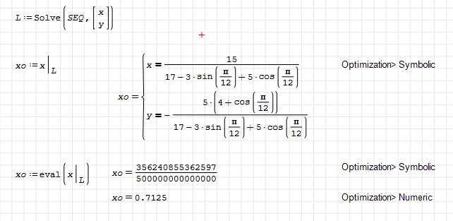

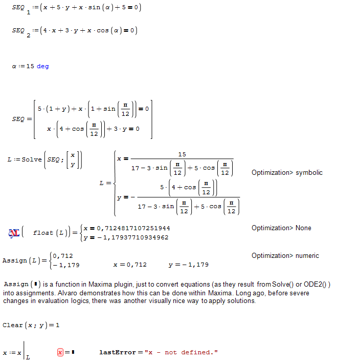

Hi Martin. I use Maxima's ev() because SMath's Assign() only works with the variable names, instead others, like xo, yo, and SMath's at() doesn't works for the symbolic evaluation, as shown this picture:
example_v1.sm (15 КиБ) скачан 56 раз(а).
This is a workaround for use only SMath native functions or plugins, without any explicit Maxima function:
example_v2.sm (15 КиБ) скачан 59 раз(а).
