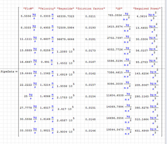

Does anyone know how to change the following units in the matrix shown below?:
from "kg/s" to "t/hr",
from " kg/{'m*'s^2}" to meters Water Column ("mH2O"),
"{'kg*'m^2}/{'s^3}" to Watts.("W")

Hello
Possibly not with your original result matrix, if you shall use results later.
It can be shown in a table region or another pseudo result matrix.
Here is the table method.
Click to enlarge
#3 Опубликовано: 24.04.2022 01:46:38
Here is your matrix with pseudo units.
Not very elegant, but it is there.
Clickto enlarge
#4 Опубликовано: 24.04.2022 03:05:54
Hola Carlos. You can use matrix algebra in the unit placeholder. Here one solution.
Colebrook_SI_CBG.sm (24,74 КиБ) скачан 1244 раз(а).

Many thanks to Overlord for his suggestions and solution.
Muchas Gracias tambien a Alvaro por su solucion.
I also thank Jean.
Carlos

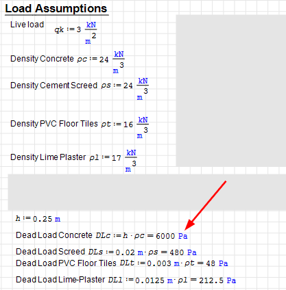

How do I set my units so my answers are in the unit I want, at the moment the answer is being returned to Pa (Pascal) and I would prefer to have the answer in kPa(KiloPascal) or even kN/m^2.
I am also getting answers in N(Newtons) and would prefer to have them set to kN (Kilo Newton) rather.

How do I set my units so my answers are in the unit I want?
Your attached document is fine. Jean's computer is broken.
About your question, there is a placeholder within results.
It will appear when you select result. It appears as a black square.
You can change your desired result units by altering it.
Here is a demonstration how you can do that.

I had a feeling it was going to be something so simple, this is brilliant, thanks!
