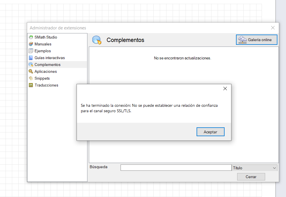

Hi there, I newbie on this software, I wanna to download plugins, but that don't loads.
I hope that, can help me, because this program is awersome.
The message is : Connection terminated: Cannot establish trust relationship for SSl / TLS secure channel.
I left a screenshot.

this could be related to certificates of the smath website not valid any more, I had issues with opening the forum site and had to confirm an unsecure connection. I think the same happens in the background when the app is connecting to the server.
Davide Carpi 13.09.2021 06:15:00
#4 Опубликовано: 13.09.2021 06:15:44
It was, should be solved now.
