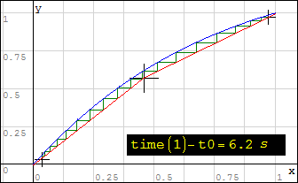

Thanks for your hard work. I would like to ask you about continued fraction interpolation. Is it possible to use this method to approximate a function like the one in the picture?
If you have it working in Smath, please attach the document.

I have attempted to construct your picture.
It produces a graph. I see no way to reduce further whereas
it is not simply numerical. If you leave it this way, then
it will track the parameters [R0, Lo, k, a] which are
presumed resulting from previous calculations.
Does it help ? ... Jean
