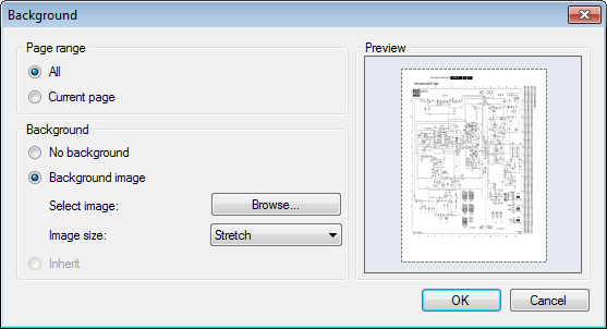

#4 Опубликовано: 12.12.2016 10:14:22
You're welcome
The background image (f.e. containing the logo or the title block) can be extended to any page, dynamic items such as the page number are accessible only in the header/footer.

Davide Carpi 12.12.2016 10:32:00
#6 Опубликовано: 12.12.2016 10:32:03
The question from post 3 is afaict about the background being applied to newly created SMath documents
Ah! Good point. As for now these settings are not stored, therefore you have only 2 ways:
  1. Save a template (a blank document with your favorite setup) and use this file when you start a new project (open it, save as new filename, start coding)
  2. Setup from scratch everytime
