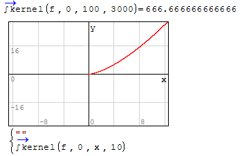

You can have 'arrow(s)' as variable name
Take care Basile ... Jean.
BasileArrow.sm (28 КиБ) скачан 67 раз(а).

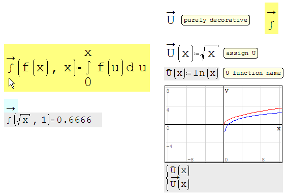

This conversation inspired me to test a few things out; apparently you can utilize a newline character within a variable name. Therefore, you don't need to 'draw' an arrow above a variable name, you can contain the arrow and the text within the variable itself!
Insert arrow character(s) and insert 'newline' to type the text of the variable (to insert a new line, paste the newline character: 「\000A\」).
Copy and paste the following into SMath:
To make this technique more transparent, I compiled a SMath Sheet (A writer region was used to display the text \000A\ without converting it to a newline character):
May this be of Good Help,
- Kenny Lemens, P.E. ᵂᴵ
⟶\000A\abc:456
