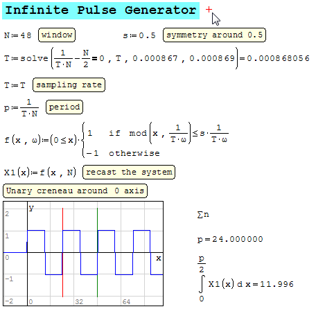

More in the attached Smath document.
Maths Pulse [Square].sm (31,39 КиБ) скачан 1036 раз(а).

Augmented version.
Maths Pulse [Square].sm (42,53 КиБ) скачан 999 раз(а).
