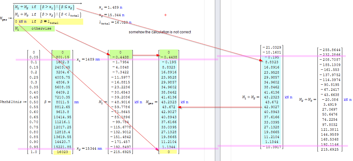

Hallo guys,
i prepared my calculation but i i am not sure if i can define my bending moment in such a way
Special look on the field moment i made
M1+M2 for
M1+M3 for
0 if....
M1 otherwise
is this correct?
thank you br Stefan
Test.sm (75,28 КиБ) скачан 1175 раз(а).

i do consider some problems i think this math code is not correct
#3 Опубликовано: 02.09.2021 12:25:14
I'm not sure what do you expect, but the values are assigned according to your logic
2021-09-02 17_25_51-2021-09-02 17_22_22-2021-09-02 17_04_09-SMath Studio - [Test.sm_].png - Visualiz.png

#4 Опубликовано: 03.09.2021 05:29:32
Stefan Müller
Stefan Müller
0 сообщений из 45 понравились пользователям.
ok thank you it seems to be correct !
best regards, Stefan
