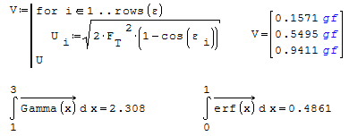

In Smath, two of the builtin functions needs be
integrate/vectorized ... if not: "x not defined".
Welcome to Smath Community.
2 more undefined 'x' complains.
1. Smath Simpson does not recognize the Power Function X^Y
2. Does not recognize Lamvert W(x)
Cheers ... Jean.
#13 Опубликовано: 18.04.2022 11:20:50
Thank you very much. Your attitude is appreciated.
You give gf
The for loop returns gf
In most applications you vectorize over sqrt
Some applications needs vectorize inside sqrt and over sqrt
Cheers ... Jean.
