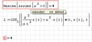

I'am not able to use the assume function.
Currently Maxima 5.42.2 is used.
I would appreciate any ideas

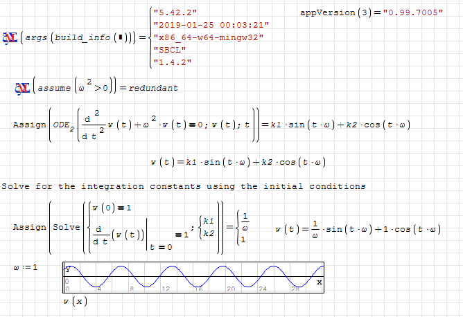

Can't reproduce.
You might want to use symbolic evaluation for the assume call.

Hi Everybody,
thanks a lot.....I forgot to evaluate symbolically the assume command....
