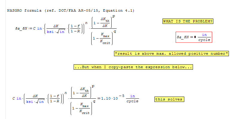

I have an error message that I can't figure out.
For the most part, I have been able to learn Smath on my own, despite the absence of any user manual, and only a few brief tutorials written by users themselves (Liengme and Urroz).
If there are any deeper manuals to recommend, I would be very happy to see links to them.
I am still relying very heavily on my long experience with Mathcad to pick this up - but it's a double-edged sword because Smath doesn't do all that Mathcad did.
One thing I would like is a list of error messages and their meaning. I can't find any references to this error expression on the SmathStudio website/forum. I could probably solve this for myself if I could find one. If I have missed an important source of information, I'm sorry, but please point me to the right place.
The file linked below is part of a very long analysis that's suddenly gone bad on me - no idea why.
Only the parts before the strange error are included. The rest is very very long.
Thank you (in advance) to everyone that can help.
I've also included a screen-capture of the offending expression:
ERROR.sm (76 КиБ) скачан 63 раз(а).

#2 Опубликовано: 04.01.2019 02:24:27
#3 Опубликовано: 04.01.2019 10:17:25
WroteOnly the parts before the strange error are included.
Smath 6179 shows no error ... puzzling vs 6884 ?

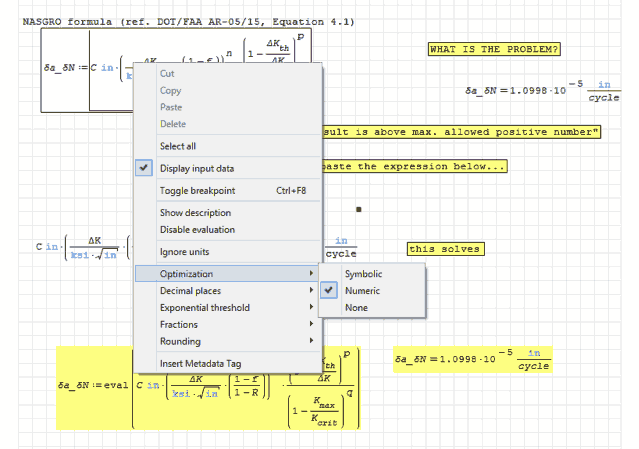

Another solution is to put the equation in numerical optimization mode,
and the error is eliminated.
ERROReval_r1.sm (82 КиБ) скачан 49 раз(а).

#6 Опубликовано: 05.01.2019 02:19:18
Wow,
Thanks to everyone for your help.
Firstly, I'm surprised that there's a simple solution to the expression that would not solve. It looks like I can globally select all the fields on a math page together and make sure they are all set to "numeric" just to make sure I haven't accidentally toggled something.

4. Unless the project is naturally all "Numeric" compatible, you have to
consider Symbolic/None as applicable by part. By default, a new work sheet
is in Numeric mode.
Page2.sm (19 КиБ) скачан 73 раз(а).
