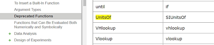

#3 Опубликовано: 21.01.2021 03:35:47
I need the following to output 4 as I'm trying to cancel out the units for a function using the variable. ...
Hi. I think that SMath's UnitsOf() it's well defined, not like the equivalent in Mathcad, which it's deprecated
and substitute by SIUnitsOf(), even the Mathcad error was related with the default unit system setup (SI=MKS, FPS or CGS): https://support.ptc.com/help/mathcad/en/index.html#page/PTC_Mathcad_Help/example_explaining_SIUnitsOf.html
As I underdestand, you want to recover the unit of a variable for plot in that unit as axis scale. But I guess that for that you must to write a 4 parameter version of your function: Plot(x,y,f(2),UnitForX,UnitForY)

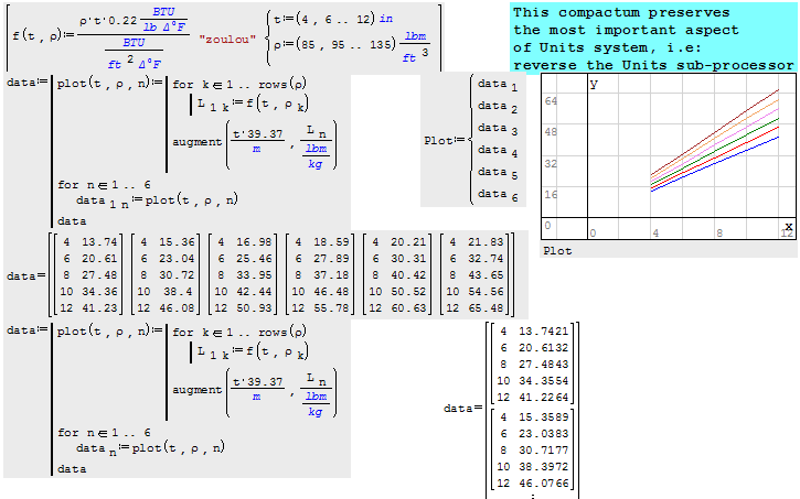

#6 Опубликовано: 21.01.2021 13:25:38
Jean,
I need the units for the formulas and as a double check. At the moment,
I just created/defined a second variable (t1:=t/in in this case) to make it work.
The unit system is an SI sub-processor.
Once it has converted in 'm' you can get a vector absent of viewing units.
At this point, if you want your original vector in you must
reverse Engineer the SI sub-processor.
Unit Waterloo.sm (20,28 КиБ) скачан 1532 раз(а).

#8 Опубликовано: 21.01.2021 17:19:25
Jean,
Your example is more detailed than mine, showing the same thing. In your case, you multiplied t by 39.37 for the conversion to inches. My intent was to "normalize" and just use the root variable to eliminate the units.
This appears to not be possible and I will just continue to define var1:=#var/units. The function is working on multiple equations, this would have been the "cherry on top".
I you have to invent a particular reverse-Engineer for an odd application,
may as well not use units, that will solve all cases.
Or, more wisely convert before hand to SI, unfortunately here,
°F, °K don't exist ... what !
No, they don't exist ... latest ITS-90 have normalized only few fixed points.
Not in °F, °K ... in °C.

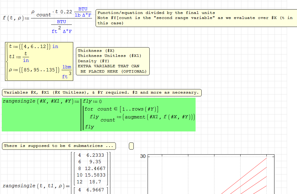

#9 Опубликовано: 21.01.2021 17:33:21
Ruben Sidranski
Ruben Sidranski
Jean,
Let's take a step back and look at the Heat Capacity sheet.
This is the one you could not open, so I'm posting the revised function below. In this example (you have your sheet to look at), I just want to eliminate the variable #X1 as all it is is the variable #X unitless. As mentioned above, I just "defined" #X1 as #X/units and we are fine. I am updating calculations to use this "generic" function for consistency. I was just hoping to eliminate having to define #X1 as a separate variable ...

#10 Опубликовано: 21.01.2021 22:26:31
Jean,
My screen is so small for so much !
You can design your own compactum.
#11 Опубликовано: 22.01.2021 00:35:12
Ruben Sidranski
Ruben Sidranski
The intent of this thread was to find a built in function to to eliminate the units (my misunderstanding of UnitsOF()). In your screenshot, you have a multiplier ... in this case, 39.37. This is what I'm trying to avoid for other equations that might be in BTU. or FT, or "widgets". Lets move on to bigger items. The simple fix is to define #X/units (t/in in this example).
