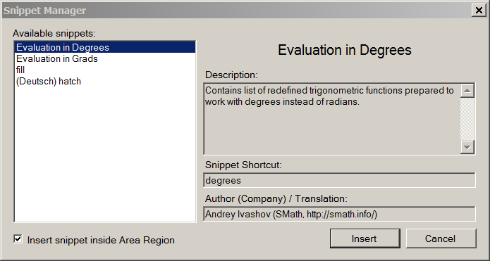

SMath Studio 0.90 will have a new interesting feature - Snippets. Here is one case how it works:
SMath Studio will have some built-in snippets, but of course every user can create its own snippets. Snippet in SMath Studio is a simple *.sm file that is placed into the special "snippets" folder. Every snippet can be inserted to the page using Dynamic Assistance (pressing TAB will insert snippet inside th collapsed Area Region; pressing Shift+TAB will insert just all snippet expressions without Area Region) or directly from the "Snippet Manager" of the "Tools" menu group.

Following Davide's recommendation, I supply the stuff as snippets with corresponding example. You may unpack the zip file in your SMath install directory, then the files go automatically to the correct locations.
Some remarks:
- The description in the snippet manager is taken from the file properties, this does not show up in the dynamic assistant.
- After insertion of the snippet, the dynamic assistant shows the the description text of defined functions along with their definition.
- The explanation text in the examples browser is taken from the file properties.

WroteThanks. The second plot takes like 20 secs to load, some english/german descriptions do not show up in the snippet manager.
English descriptions were incomplete, fixed. And, yes, the fill function is slow (no performance optimization done so far). I had the idea of making coloured contour plots using dots with computed colors, but given the lousy performance I think that is a bad idea. On top of that, most graphics tricks are obsolete as soon as any of the plugins under construction are mature and feature-rich enough. Matplotlib would be nice, but there is few hope as they have no c# api.
My newly gained snippets experience has found it's way to the Handbuch now.
