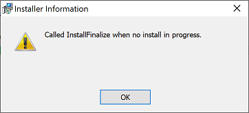

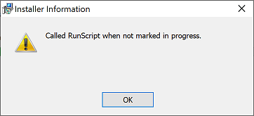

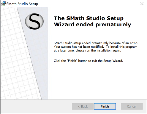

I am getting installation errors when attempting to install SMath Studio (from SMathStudioDesktop.0_99_7030.Setup.msi) on a Surface Pro 6 running Windows 10 Home. Two pop-up boxes appear, "Called RunScript when not marked in progress."; and "Called InstallFinalize when no install in progress."
I can install from the Microsoft Store but its version does not include the menus (there is another topic related to this).
I can install SMath Studio on a different PC running Windows 10 Pro.
Screen-shots and DXdiag output is attached.
