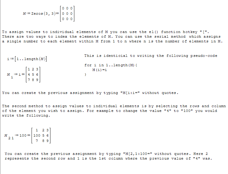

For example, it would be useful to be able to matrix element assignemnts instead of always clicking the matrix panel to the right.
Is there a way to see the syntax to the panel buttons to figure it out?
Please take a look at the following file.
Matrix Example.sm (6,24 КиБ) скачан 1172 раз(а).

THANKS! The last bit is what I needed to get el(3) instead of el(2).
Dennis
