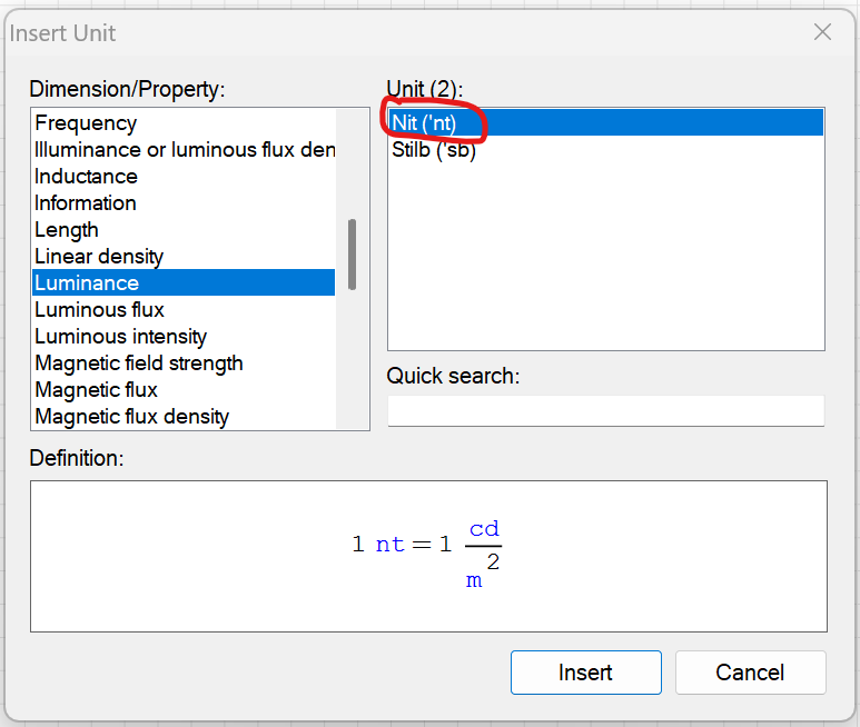

#3 Опубликовано: 27.12.2024 19:00:24
The non-SI nit unit of measurement added to the Luminance dimension;
New unit of measurement added:
ioan92 27.12.2024 19:38:00, Oscar Campo 27.12.2024 20:01:00, Israel Espinoza 27.12.2024 20:28:00, Alvaro Diaz Falconi 29.12.2024 00:41:00
