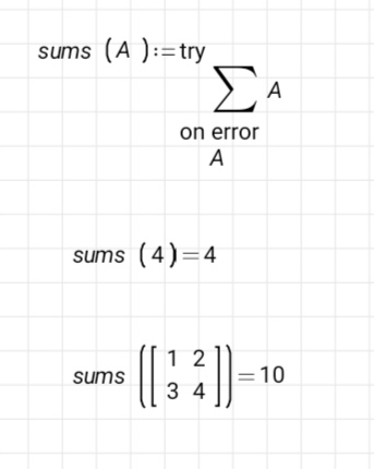

#2 Опубликовано: 18.04.2022 09:50:44
#3 Опубликовано: 18.04.2022 09:51:14
Laurent Fournier
Laurent Fournier
9 сообщений из 66 понравились пользователям.
Hello I found a solution:
suml(a):=line(
a:=stack(a,0)
sum(a)
Sorry to have bothered this forum with such a basic question !

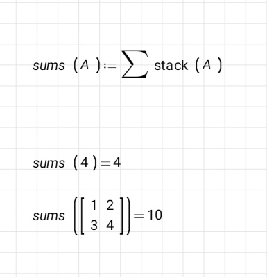

#5 Опубликовано: 18.04.2022 10:22:36
You're welcome
Note that using the stack approach you don't need the zero
#6 Опубликовано: 18.04.2022 11:07:54
Laurent Fournier
Laurent Fournier
You're welcome
Ha! :d :d That's puzzling! You can "stack" nothing on something!
