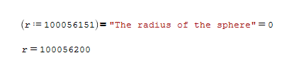

May I ask what the purpose is of setting some of the equations equal to a string with the Boolean equals operator?
#4 Опубликовано: 17.07.2018 08:55:47
Arie
Arie
93 сообщений из 285 понравились пользователям.
It just allows one to describe the equation. Note that the assignment operator is used in parenthesis. This actually performs the assignment to the variable.
If you were to actually evaluate the expression, it would evaluate to 0 (False). This makes sense because the string is not equal to the value assigned.
