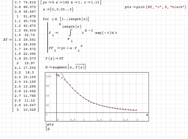

Hello Jean
A few small changes in the part that is shown.
Maths Special Gamma(a,x)_Quick Copy_R1.sm (71 КиБ) скачан 79 раз(а).

Playing a little test and error with the
coefficient y0, a, b, and n,
you get a better fit in the curve.
Maths Special Gamma(a,x)_Quick Copy_R2.sm (68 КиБ) скачан 74 раз(а).
Carlos

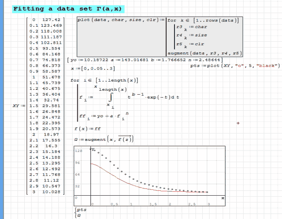

#4 Опубликовано: 13.10.2018 16:24:36
Thanks Carlos.
Here is an even better fit from your data reduction method.
Data reduction was introduced in the Mathcad DAEP [2003].
Kiby2 is stricking of realism ... attached.
More was done: linearisation of T/C [Thermocouple]
Genfit 000Carlos.sm (42 КиБ) скачан 85 раз(а).
Genfit Kirby_2 [Reduced].sm (75 КиБ) скачан 76 раз(а).
