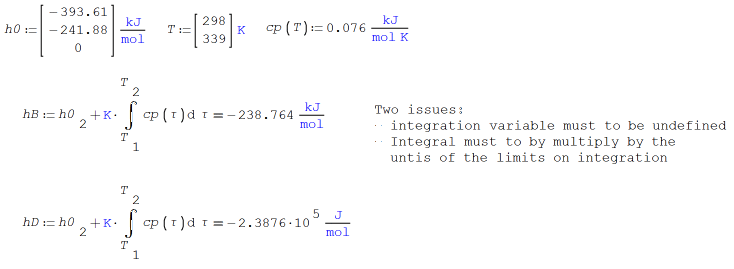

Hi. Try this:

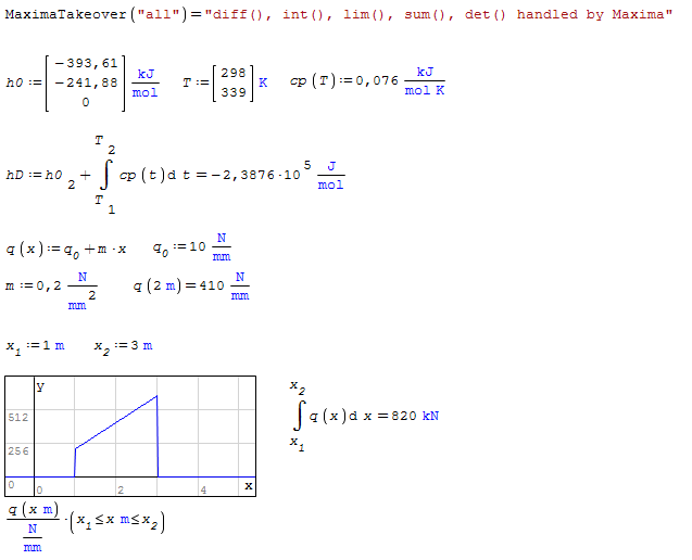

Maxima can handle integrals with units. Yet the restriction applies that the integration variable must be undefined.
int_issue_Kr_units.sm (10,14 КиБ) скачан 1119 раз(а).

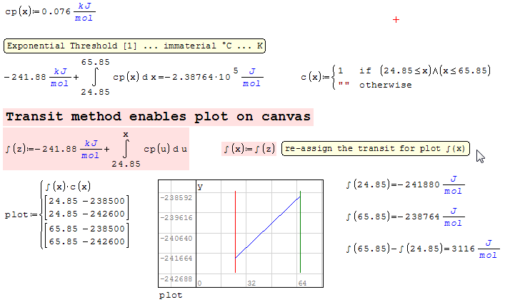

#7 Опубликовано: 01.04.2019 22:49:00
Native Smath does it in much greater elegance.
int_issue [Transit Method].sm (9,39 КиБ) скачан 904 раз(а).

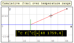

#8 Опубликовано: 02.04.2019 09:14:40
Refreshed version managed from annoying units
Integral 0000000 Transit-Units.sm (23,78 КиБ) скачан 1135 раз(а).
