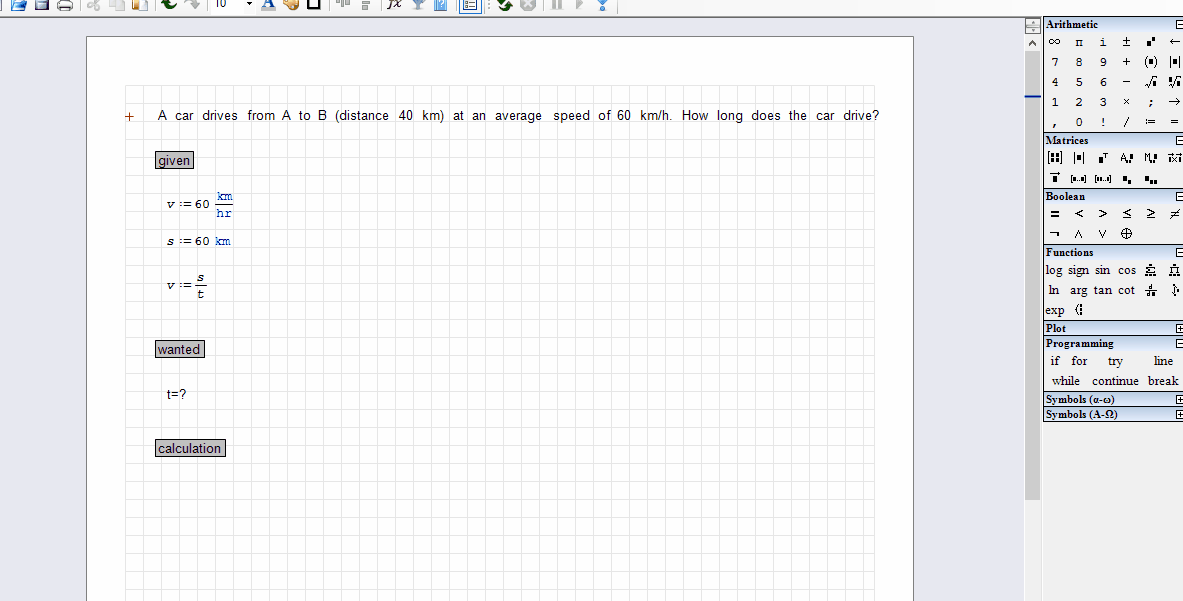

Hello, I would like to do simple calculations with SMath, transform formulas and then use the numerical values. Is that possible? I am new to SMath and unfortunately I didn't make it.
Thanks for the help

Hi Carlos! Thanks for the quick response. Your document works very well.
I tried to copy it, but unfortunately I failed.
I have created an animation of my work steps.
Maybe you or someone else can help me where I make mistakes.
Thank you very much and a happy new year.

I've come to understand it by now. The unit is removed by multiplication.
It works now.
