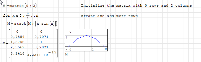

#8 Опубликовано: 03.02.2017 21:29:55
Example for declaration and use of an empty matrix:
stack.sm (11,99 КиБ) скачан 1454 раз(а).
Arie 03.02.2017 22:03:00
#9 Опубликовано: 03.02.2017 22:03:19
Arie
Arie
Awesome. Thanks, Martin. I did not know that empty matrices were supported.

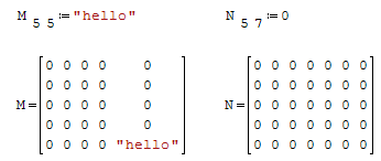

#11 Опубликовано: 04.02.2017 10:32:43
... technical matrix
