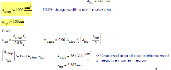

Is there any way that this could be replicated? I've been using solved symbolically and FindRoot but if there is another intuitive go around would be appreciated. Yellow marked were initial values for finding the roots.
Thanks in advance~

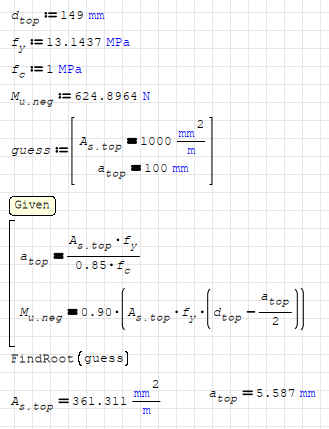

There is Mathcad Block similar to this.
Here is the answer to your question.
Actually there is no intuitive here, it is just habits.
FindRoot(), roots(), solve(), al_nleqsolve(), etc are easier to me.
Because I am more used to work with them.
You possibly will be more comfortable to use Mathcad Block.
Because you used Given,Find functions for long.
mathcad_block.sm (6,75 КиБ) скачан 1644 раз(а).

Well first of all I thank you for your reply.
I pretty much know about the FindRoot(), roots(), and solve() from practicing with mathematics problem, but I don't know if I missed out but I haven't encountered this al_nleqsolve(). Would you demonstrate how this works?
Also, one big thing. I don't know how the Mathcad block works. I can't recreate what you did. Like I said I can do this with the FindRoot() but I'm pretty much looking for another way to present/solve it. I kinda like the way it turned out in the way you do it but I can't seem to recreate it with my smath.

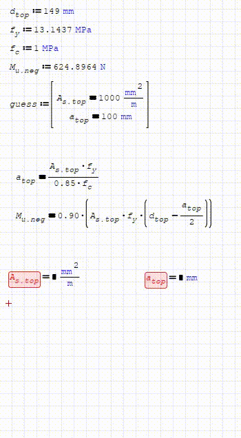

I will assume you have installed Mathcad Toolbox plugin.
Its requirements works similar to FindRoot() or other solvers.
When you add block and click on it a blueish rectangle area appears.
Your unknown functions has to be inside of that area.
And you need to write your solver with start points/guesses to its handler.
Here let me show it with a gif explains on your question.
More info can be found in Extensions page link below.
Mathcad Block has very detailed examples on its own page.
https://en.smath.com/forum/yaf_postst726_Mathcad-Toolbox.aspx
Thanks again, finally did it.

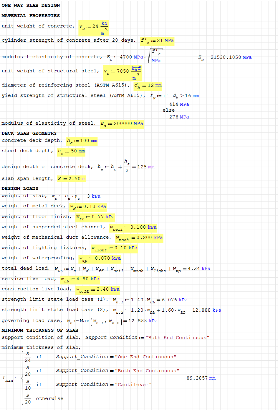

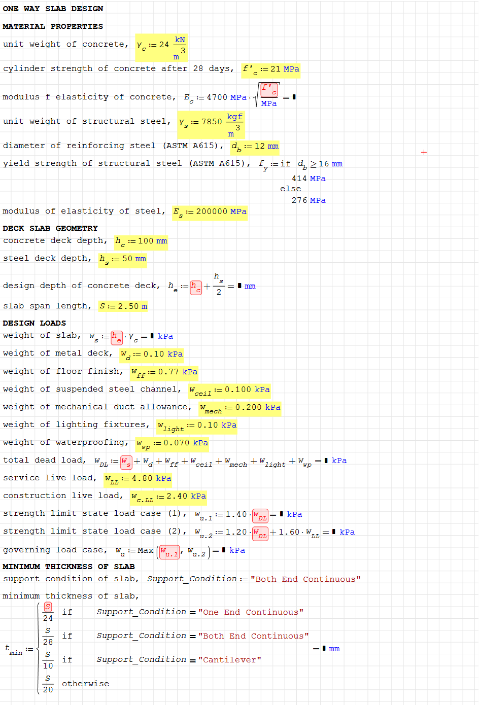

(1) Where does that cream-colored rounded rectangles come from? Is that a text region, a special function? I tried to replicate that days ago but I went blank how to.
(2) May you look at the image below. I generally use: [text goes here, variable:=1mm] all in the same line and it comes blank. This was not available in Mathcad and was actually a good thing for me since I possibly can't misplace their descriptors whenever I'm moving things,especially variable, around. Problem is this one makes an error for me. Is what I'm doing a bad practice?
I'm trying out and contemplating on migrating from Mathcad to SMath so forgive me for being a little bit ignorant.
Thanks
Those are description text.
Right click to math/plot/table rehion and you will see an option from that menu.
(2) Is what I'm doing a bad practice?
İt is all up to you.
Don't think it as bad or good.
There are sheets you activate description and it is enough.
And there are some you put text region.
İt depends on visual aestethics of that particular sheet.
By the way, SMath is similar but not same to Mathcad.
Don't expect 100% conversion. But you can do everything on SMath as done on Mathcad. One way or another.
