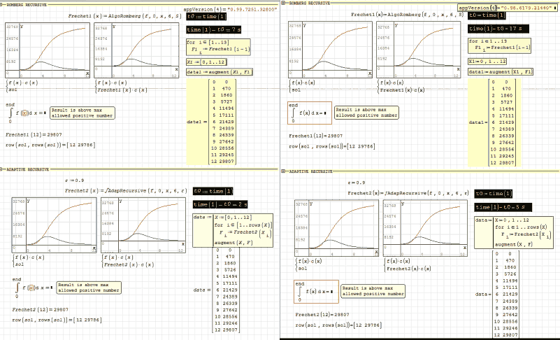

The Design Engineer faces 3 hard tasks:
1. Integration
2. Model fit data set
3. Solving
Smath native integrator ranges from:
exact [trivial cases], excellent, acceptable ... pure freak.
The native integrator does not integrate Frechet, poorly the Naive.
Integrate Frechet.sm rescues both: Frechet 4 optons, Naive 1 option.
More difficult integrations are integrated via Carlos Adaptive,
attached/exemplified in Integral MASTER ToolBox.
Both documents are in SS 6179 ... no red or red explained.
Start by Frechet, that will put you in gear !
Lot more in the immense Compendium [arc length, discontinuous ...]
Enjoy your visit ... please: don't hesitate for +.

Hello Jean
Apply the recursive Romberg method and the recursive adaptive method to your function.
Integrate Frechet_Jean_CBG_SS6179.sm (52,54 КиБ) скачан 1302 раз(а).
Integrate Frechet_Jean_CBG_SS7251.sm (55,26 КиБ) скачан 1276 раз(а).

Carlos
WroteHello Jean
Thanks Carlos, saved for reference
