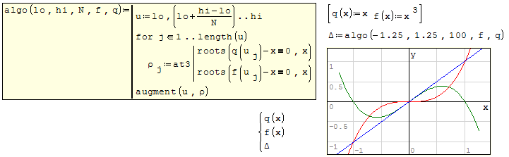

... here is a typical seeded roots scanner.
You can spline for in-situ calculation.
Solve Inverse [Seeded Scanner_roots].sm (16,52 КиБ) скачан 995 раз(а).

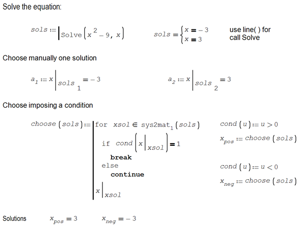

Hi. You can try this approach.
filter maxima solve solution - choose.sm (8,72 КиБ) скачан 1197 раз(а).
Thanks! Very interesting use of the at() function, I didn't know it could be used with Boolean also. I not fully understand what the line() does to Solve(), but I tried without and and seen for myself that it will not work without.

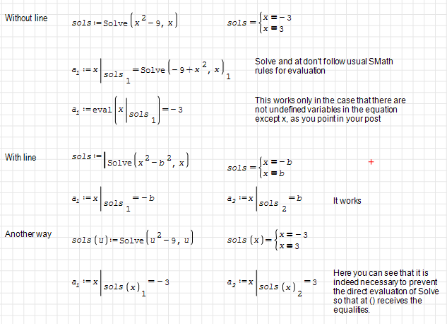

the line is local definition.
sols:=]for the double vertical ▄
back space on the 2nd one
in the active ▄ solve(x^2-9,x)
More down the document is of local definition style.

... the function at(2) is native local definition
... the function at(3) is used as differential operator.
#13 Опубликовано: 18.10.2021 13:46:19
... I not fully understand what the line() does to Solve(), but I tried without and and seen for myself that it will not work without.
Hi. line( ) does the same as defining sols (u) = Solve (eq, u)
filter maxima solve solution - line.sm (11,49 КиБ) скачан 1202 раз(а).
