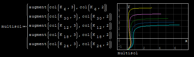

2. I noticed that if you want to get the graph of the 2nd example, it is
wise to have Smath not open. Then reach were it downloads and click 'open'.
I noticed this behaviour with other work sheets not created in Smath 5346.
3. If you delete the if/else and conserve augment(col(el(K,tt),3),col(el(K,tt),2))
you can have each individual "Frame" by setting tt => 6..30 and export each
individual "Frame" solution.

#11 Опубликовано: 16.08.2016 00:31:23
... like this:
