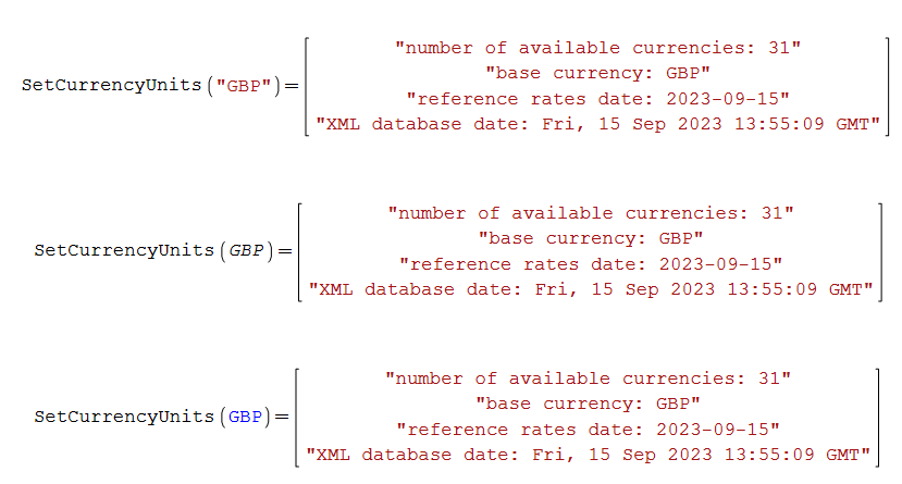

#6 Опубликовано: 15.09.2023 17:48:11
Hello, The SetCurrencyUnits() function is not posting the current rates.
Fixed both SetCurrencyUnits(1) and SetCurrencyUnits(2), plugin released for latest version of SMath Studio stable.

#7 Опубликовано: 17.09.2023 19:43:16
Norm Schutzkus
Norm Schutzkus
9 сообщений из 90 понравились пользователям.
Many thanks, for your follow back. The date is more recent (was 2015), my date now posts: "reference rates date: 9/22/2022 12:00:00 AM" and "XML database date: 1/1/0001 12:00:00 AM".
I am currently running 1.0.8348.30405. I assume this is the latest stable release?
I welcome your review and look forward to your reply.
Sincerely,
Norm
#8 Опубликовано: 18.09.2023 05:08:57
That's odd. I'll check if I can add some sort of log to investigate the reasons. It might be a firewall problem?
Yes, the plugin is fixed for the latest SMath Studio stable and future versions (>= 1.0.8348).

#10 Опубликовано: 19.09.2023 19:03:48
Norm Schutzkus
Norm Schutzkus
Ah-ha! My plugin required updating. All works well now.
