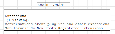

This happens when the clipboard contains strings with spaces (Win7 x64 / SMath Studio 0.97)
P.S. this not happens using the nightly build 0.96.4909

update: I notice the same issue even when I copy and paste a string with spaces from a text area to the canvas (so probably the HTML data is not the cause)
#3 Опубликовано: 12.02.2014 17:10:56
Cannot reproduce on latest 0.97 (tried the same text you shown on screenshot and some others).
May it be caused by some plug-in installed? If you will find it out I hope to find a way to prevent such kind of problems in future.
