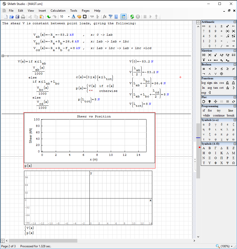

I've tried many ways from examples I have found on the internet, but I just can't get the graph to plot. What am I doing wrong?
Any help would be greatly appreciated.

Hello Dave,
maybe a simple scaling problem? Your results are of magnitude 8 N, your plot is in [kN].
Try scaling the plot area with [Ctrl]+scroll wheel or [Shift]+ scroll wheel.
Hope this helps...
Regards, csb.

#5 Опубликовано: 04.10.2017 12:07:09
Input units are needed... in the standard 2D plot, just use p(x*'m) / V(x*'m)
#6 Опубликовано: 04.10.2017 12:18:53
1. The X_Y plot does not take conditional
2. Quick plot does not take units [there is way to trick]
3. units removed from the two conditional ... plots !!!
Cheers... Jean

Yahoo! Thanks Jean! I understand the problem!
Dave
