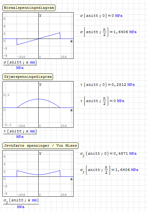

Seeing how fast I got great and helpful answers yesterday, I thought I might ask another rather silly question. I am trying to animate a plot, and I have never done it before.
I have made a simple sheet ploting V,M for a rectangular simply supported beam with uniformly distributed load. I have also plotted sigma and tau for the section, as well as Von Mises.
I have tried to make 3D plots to show how stresses evovle through the length of the beam, and to some extent it illustrates that.
I have also tried to animate a 2D plot, to work like a cross section that moves along the length of the beam, but I cannot figure out how to make it work.
Any ideas where it went wrong for me?
Also; is it possible to plot stresses along y-axis as opposed to x-axis?
Thanks again :d

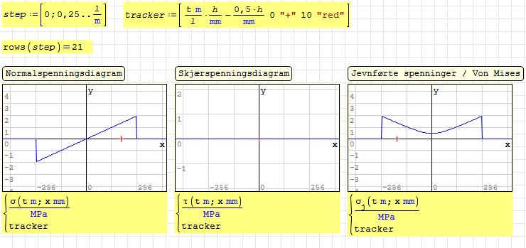

Well, I got the animations to work. I guess the mistake was to try to animate on a variable named 't'.
With a bit more tinkering I should be able to plot my stresses about y-y axis as well.
Best regards,
Hans Kristian
spenninger bjelke.sm (32,03 КиБ) скачан 1179 раз(а).

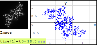

At least, my small laptop does not smoke.
Pattern Julia Set [PUBLISH].sm (25,09 КиБ) скачан 924 раз(а).

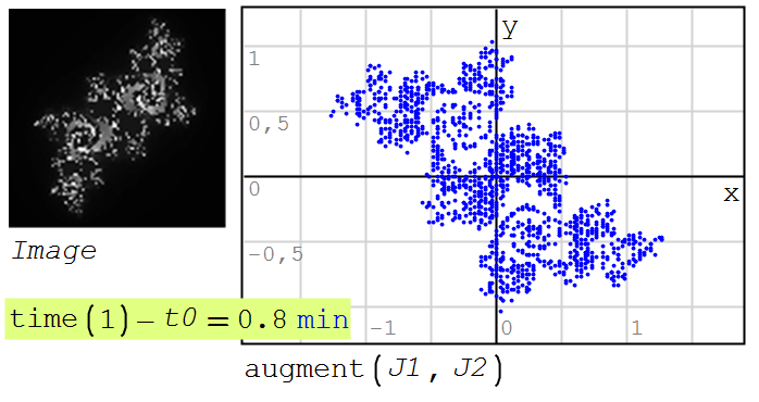

0.8 min using latest 7251:
Significant (20x) performance improvement for 3 years.
#15 Опубликовано: 08.11.2019 21:42:22
Impressive improvement ... MCD 11 XP Pro [4 sec]
Thanks Andrey ... Jean
