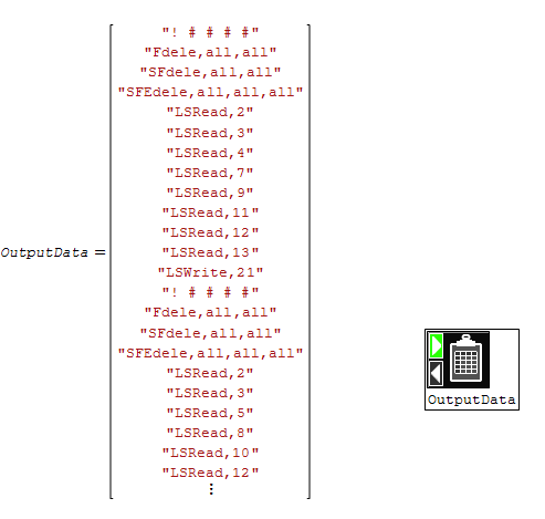

I'm need help.
I'm want to export my Matrix with strings to new txt file.
My result - txt file with quotes near all values.
I need file without quotes.
Any Ideas?

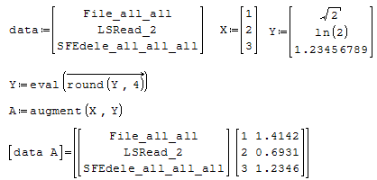

#3 Опубликовано: 17.03.2021 09:56:01

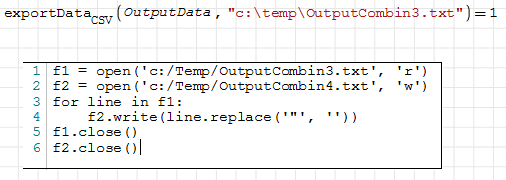

This my temporary solution.
Now i'm want solve problem with paths... May be...
LoadCombination3.sm (15,74 КиБ) скачан 1167 раз(а).
