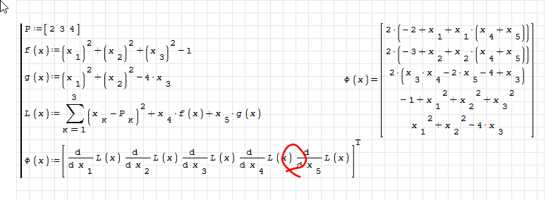

The sum of derivatives has problems. The last line is missing

The sum of derivatives has problems. The last line is missing.

just a typo (+ instead of argument separator after 4th entry)
