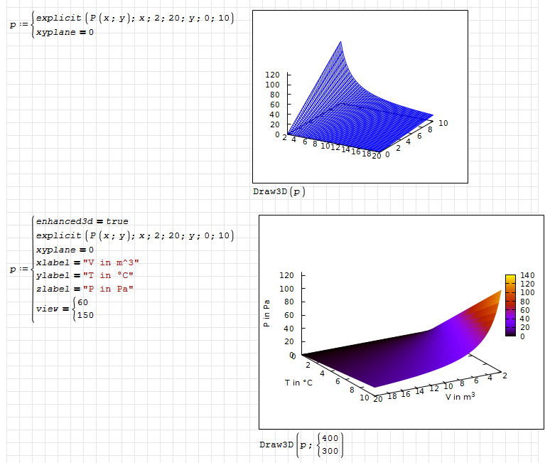

This is a version using the draw function of the Maxima plugin. The commands are described and demonstrated in Section 6.1 of the german SMath Handbuch
P701E02_Kr.sm (224,5 КиБ) скачан 1546 раз(а).

Thanks Martin,
Now I have to overcome the "no maxima.bat" problem. .
Your solution allows rotation of the plot?
Dariusz
#4 Опубликовано: 05.10.2020 13:24:49
For configuring maxima, see the link in the signature.
The given solution controls the orientation by the view parameters.
Yet there is a so called Maxima Draw3D region, where interactive rotation is possible, at the price of slightly less stability (the region might freeze).
