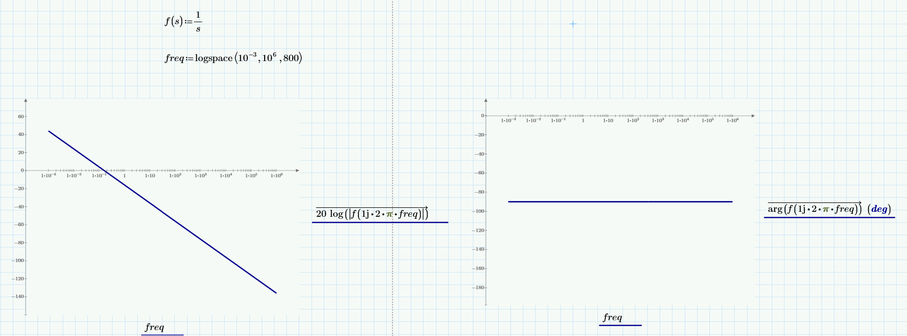

How to make bode plot in Smath Studio like below in Mathcad prime?
Only x-axis is in logarithmic

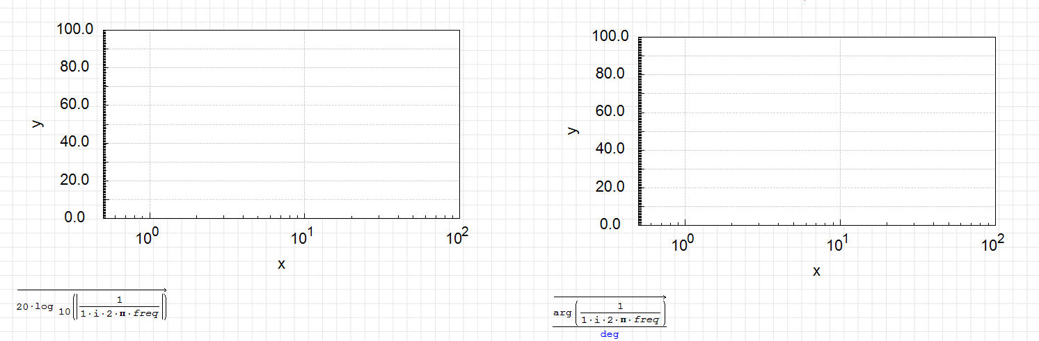

But how can I plot these 2?

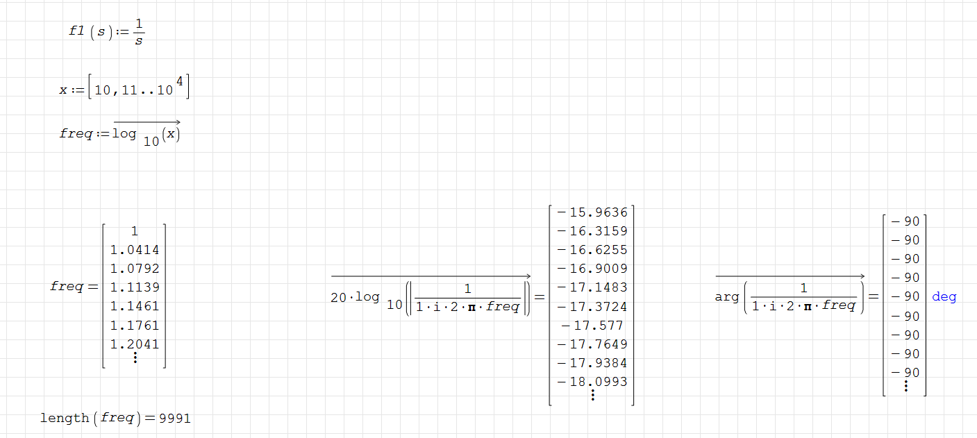

The arguments for a plot must be a function or a couple of column vectors.
I your case you can use in your plot the vectors you are calculated and use as input for the graph:

But I want to plot augment(freq, 20*log()) and augment(freq, arg()), which does not work..this îs the problem

augment(freq, arg()) and augment(freq, 20*log()) really works... only must adjust the axis... your yaxis is set 0~100 and your data appear in the 0~(-100) axis
