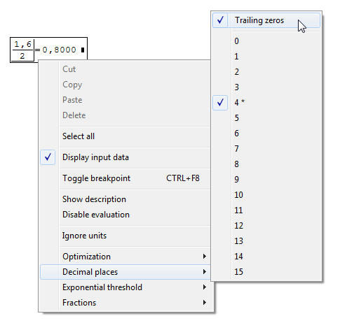

Hello [userlink]m227[/userlink],
have you tried the "trailing zeros" option in the context menu?

#3 Опубликовано: 19.04.2017 12:15:09
m227
m227
4 сообщений из 29 понравились и 1 не понравились пользователям.
Davide, you saved my day.
So this post can be deleted. I don't know how could I omit this, blind am I...
