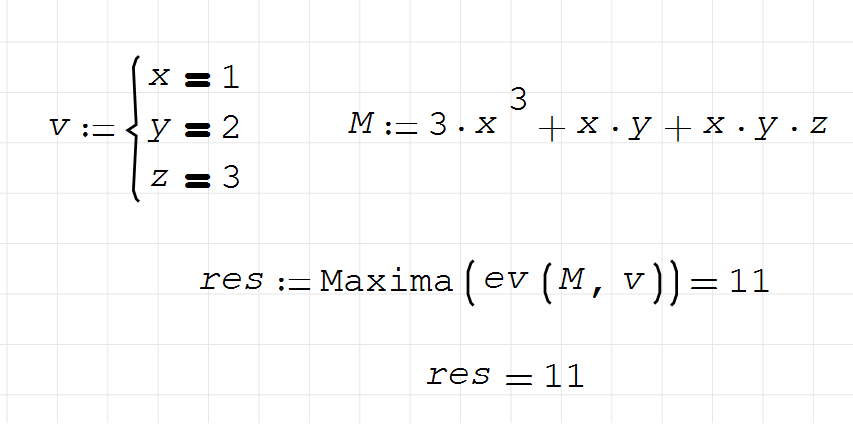

Dear all:
I am new to Smath Studio, great software!
Even I am new to its usage, I am trying quite complicated calculations I guess.
I am putting the following lines:
As you can see, I am using Maxima plugin and the Maxima function ev() to substitute values in the symbolic variable. I have some specific questions:
1.) Is there an alternative way to do this kind of calculations without using the Maxima plugin?
2.) v is a system of values, each value is an equality, is there an automatic way to generate a system of values?
Thank to all the people that could help.

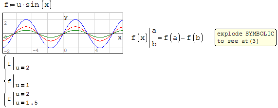

#2 Опубликовано: 12.04.2022 17:04:06
I can't open your image. From what you describe, you might want to use the substitution function at() from Custom Functions plugin.
at.sm (22,23 КиБ) скачан 1211 раз(а).

#4 Опубликовано: 12.04.2022 18:51:35

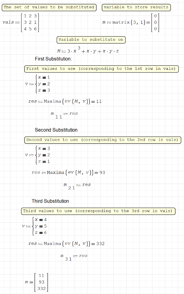

Sorry about the image, now the image is visible.
What I want is to iterate over a set o values to substitute in a variable a store the results in a variable, something like this:
Is there a way to do this substitutions in an iterative way?.
I mean: using a set of programming lines?
In this worksheet I copied and pasted the lines to perform the iterations, but in a general problem solving it is desirable to iterate automatically.

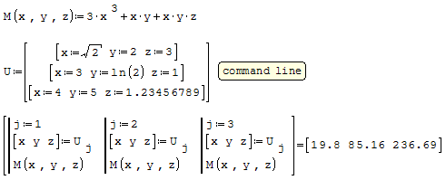

#8 Опубликовано: 12.04.2022 21:29:50
An iterative process is a solving process.
As you say, you just want to plug something from command line.
#9 Опубликовано: 12.04.2022 23:45:16
Mario Acevedo
Mario Acevedo
0 сообщений из 11 понравились пользователям.
wow!, this is what I was looking for!!!, THANK YOU very much Jean Giraud!

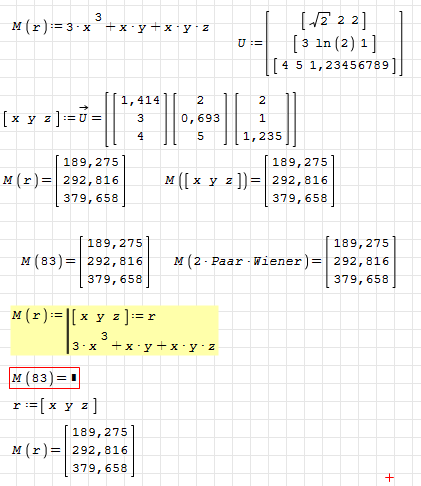

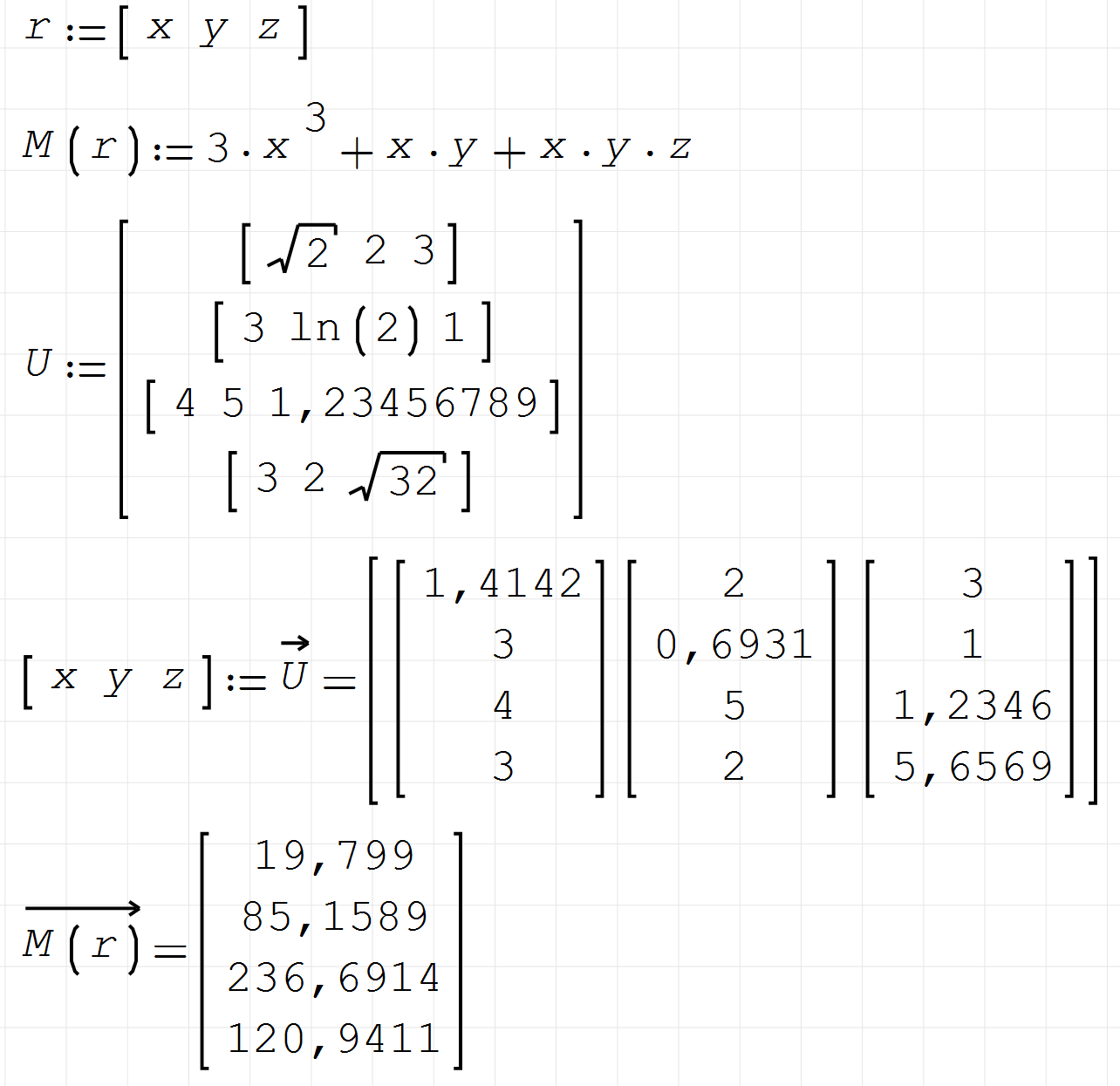

I take inspiration from Jean, but I use the Vectorize function and I forget the size of U
Показать спойлер
FunzioniVettori.sm (6,37 КиБ) скачан 1158 раз(а).
#11 Опубликовано: 13.04.2022 08:21:09
Martin_B
Martin_B
22 сообщений из 84 понравились пользователям.

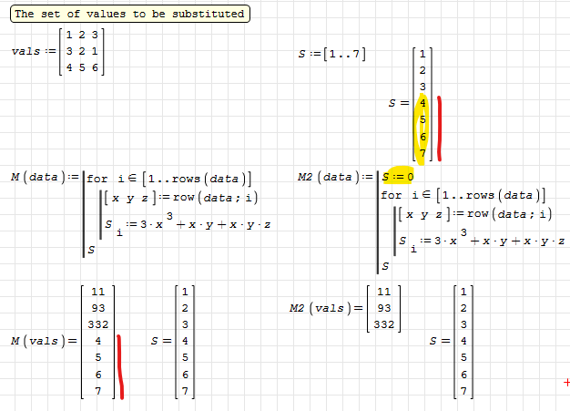

Pay attention! The definition of M(r) doesn't make much sense.
#12 Опубликовано: 13.04.2022 08:41:51
Superb Sergio ... added in the main document.

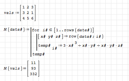

#13 Опубликовано: 13.04.2022 09:48:44
An algorithm can also be used.
It may be simpler by this way.
Worksheet1_algorithm.sm (4,69 КиБ) скачан 1199 раз(а).

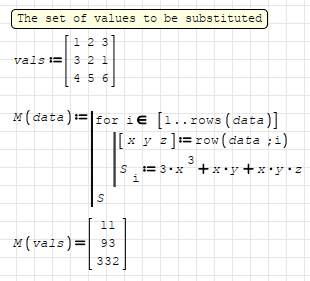

#14 Опубликовано: 13.04.2022 14:10:35
Mario Acevedo
Mario Acevedo
Nice implementation!!
Just a question, does the S variable had to be declared and dimensioned previous to its use?
I will try the code asap!
Thank you !
#15 Опубликовано: 13.04.2022 14:48:08
Martin_B
Martin_B
You should always define variables used as arrays in function before assigning elements.
Worksheet1_algorithm.sm (8,04 КиБ) скачан 1192 раз(а).

#16 Опубликовано: 13.04.2022 16:04:10
Just a question, does the S variable had to be declared and dimensioned previous to its use ?
No, it sets by itself within the for loop.
Wise to clear within the algo ... U:=0
That will avoid interaction with else U above document.
Algo style is an immense companion in Smath.
Personally, I use it as much as possible,
it enables the local command line.
Cheers ... Jean.
Maths algo style MATRIX in_extenso.sm (5,88 КиБ) скачан 1215 раз(а).
MarB is dead right.
Array variables should be considered carefully if they will be redefined multiple times.
Or they can be undefined and named uniquely. I tend to name variables in functions this way.
You can find below how I would name your functions variables.
Pretends mess of misusage.
#18 Опубликовано: 13.04.2022 17:55:24
It isn't required but it is good practice. If the variable name already exists you might fall in some unexpected cases when the dimensions are different. In addition to the above suggestions, you can use also a Clear(S) as initializer.
