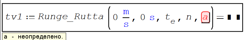

Why I have an error in second sheet?
Rocket-s-Euler-RK.sm (89,49 КиБ) скачан 1591 раз(а).
Rocket-s-Euler.sm (28,67 КиБ) скачан 1594 раз(а).

Runge_Kutta not Runge_Rutta
Also extract t1 and v1 from tv1.
Rocket-s-Euler_b.sm (34,4 КиБ) скачан 1663 раз(а).
Thanks!
But see please the error message
It's an extremely misleading error message!
