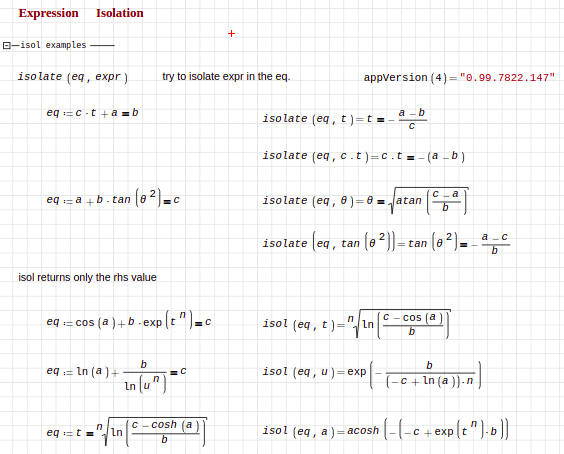

#4 Опубликовано: 28.12.2021 14:48:20
Does smath know how to do that?
Yes, this worksheet is "pluginless" and can isolate expressions from an equation in some cases.
isol_n2e.pdf (52,97 КиБ) скачан 634 раз(а).
isol_n2e.sm (73,81 КиБ) скачан 1155 раз(а).
For instance, it works also in the SMath in the cloud: https://en.smath.com/cloud/worksheet/HpYWFrCC
And if so, is it capable of doing simplifications when doing so with more complicated equations?
Simplification and isolation aren't the same. The exposed concept can be extended to develop a series of rules to apply to simplify expressions for some type of 'simplify' function, or rules can be added to solve more complicated equations.

#7 Опубликовано: 28.12.2021 17:33:22
This is very good homebrew function. Thanks Razonar.
