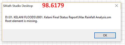

Hi
Attached SS file (98.6179) crashed and unable to recover.
Max Rainfall Analysis.sm (0 Б) скачан 1301 раз(а).
#2 Опубликовано: 09.01.2017 11:40:26
"Root element missing"
Work sheet is empty: it was not saved most probably because some
character not allowed in the file name... why crashing Smath ?
Normally, Windows would issue a message telling "not allowed filename".
Can't help more: reconstruct from blank, simple work sheet name.
Any other failure of 6179 ?
#3 Опубликовано: 09.01.2017 12:03:15
Totally empty file. AFAIK is the first case since a long time.
Any clue about what could have triggered the crash? (since the last successful save, have you done/added/deleted something unusual, some action while saving?)

#4 Опубликовано: 09.01.2017 12:27:27
NDTM Amarasekera
NDTM Amarasekera
I was making some minor changes to the working file.
When trying to select and move some assigned variables, then suddenly got the "usual warning that Smath does not respond".
When clicked to quit, got an option to save it and clicked to save.
The file closed, but then unable to reopen any more (showing the above error message).

#5 Опубликовано: 09.01.2017 13:43:40
Thank you for the report! I thought we have no such issues anymore...
To finally fix it I think SMath Studio should never immediately replace files on Save, but always create a new file next to existing one and replace old one with a new file only in case it was correctly saved.
Will implement this logic asap.
I hope you have a backup of this worksheet as there is no any possibility to restore it using a file you have attached.
