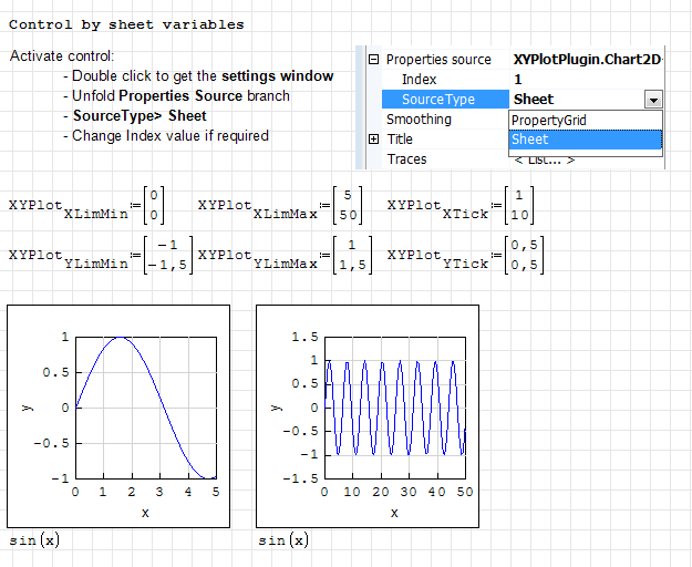

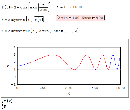

Only Xmin, Xmax [quick]

Thanks for the response Jean.
I believe I have worded my question poorly. In your example the "XTick" appears to be 250 and the YTick appears to be 1. This can be adjusted if I right click on the graph and go to format then adjust the "XTick" and "YTick". I am asking if it possible for me assign these variables on the canvas rather than having to go into the format dialogue box.
Section 2D plots XY Plot Plugin.sm (91 КиБ) скачан 92 раз(а).
