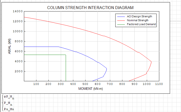

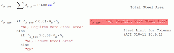

I've attached a file to generate the Compression and Bending Interaction diagram for rectangular sections, using ACI 318-11.
Any SI and US customary units work, but the results are in kN-m, which can be switched manually if you know where to look.
The rebar area and location column vectors can be made larger or smaller with no effect to the algorithm, So any number of steel layers can be used.
Future work: Expanding on this to include Biaxial Bending using the Reciprocal Load method. I had done this previously with MathCAD, and am currently working on a version for smath. I am having trouble getting it to be done without human input at certain points, but will keep working on it.
Please upload any improvements done to this file and post if any mistakes are found or if you have any suggestions.
Updated: Automatic scaling of the plot has been implemented. Also previously the section was treated as compression controlled, now the transition from compression controlled to tension controlled is taken into account.

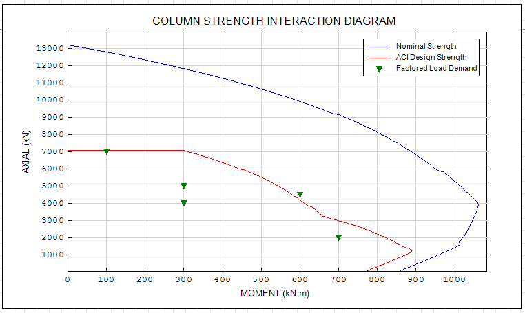

I have reproduced the diagram in Maxima Draw2D with automatic scaling (except for the x ticks, which are hardwired). Also, I parametrized the usage of units in the plot. One might even use radiobutton list regions for unit selection and having appropriate dynamic labels in the diagram.

You know, another nice feature would be if there was a way to check if the point falls within the curve, then return an "OK" or "NG" or something along these lines. Of course it is easy enough to visually compare but it would still be neat.

To accomplish the task you can use the even-odd rule.
Attached an example.
Check.sm (15,7 КиБ) скачан 1285 раз(а).

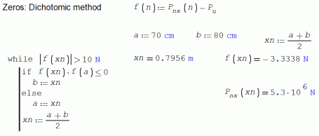

2) I want to find n value that satisfies Pnx = pu.
when I use the solve() function, an error occurs.
Is there a way to fix it?
how can find n value ?
Please refer to the attached sheet
Hi.
The formulae for apply is valid only for certain ranges. You can see that the surface is outside the required range (by the norm), so, the SMath error actually is irrelevant: what it's important is the red in the worksheet:
Solvers are unstables, except maybe for al_nleqsolve. But here, and similar cases, you can implement always your own solver:
Wrotewhen Iuse the solve() function, an error occurs.Is there a way to fix it?
... more solvers in there.
Solve Dichotomy.sm (19,94 КиБ) скачан 1177 раз(а).
Solve roots Newton-Raphson.sm (51,33 КиБ) скачан 1200 раз(а).
Solve roots_solve RootSecant (1).sm (104,62 КиБ) скачан 1189 раз(а).

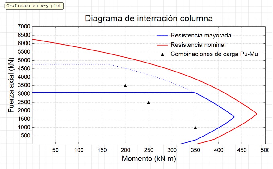

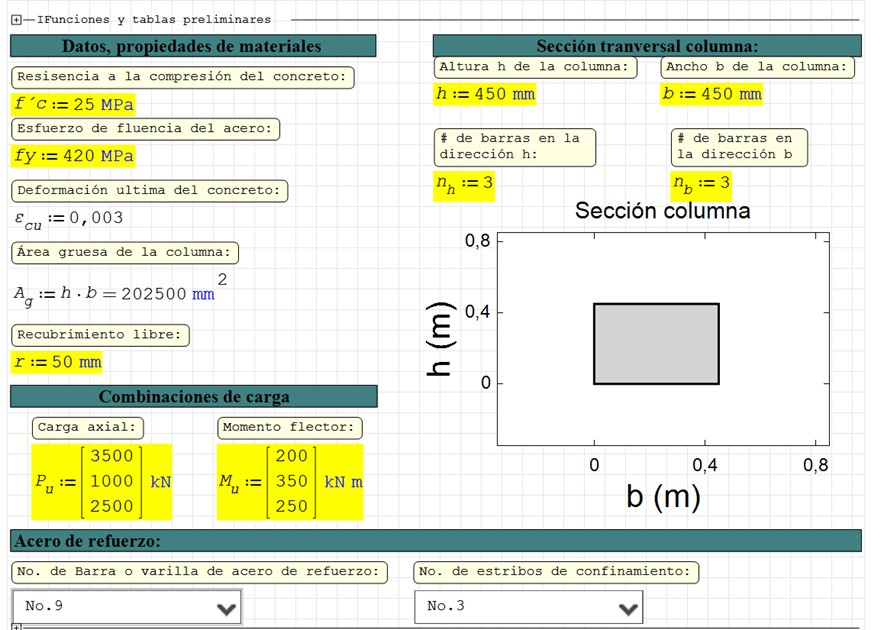

I had made my own code, but I was missing graphing, I took as a guide the code previously published here and additionally I added the graph the cross section of the column and the load combinations P-M, it would be missing to add the steel bars to that section to have a better graphical interface.
I will work to complement the code with bresler's reciprocal load method.
Diagrama de interaccion.sm (848,38 КиБ) скачан 1322 раз(а).
