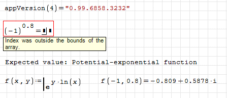

#1 Опубликовано: 15.10.2018 13:08:46
Hi. Just some mistake.
Potential-exponential function error.sm (4,07 КиБ) скачан 1293 раз(а).

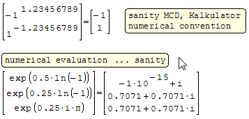

#2 Опубликовано: 15.10.2018 15:49:48
The default convention is a bug by itself.
That it does not default to "convention" suggests incomplete user coding.
Maths Exp(,) Convention.sm (26,12 КиБ) скачан 1256 раз(а).

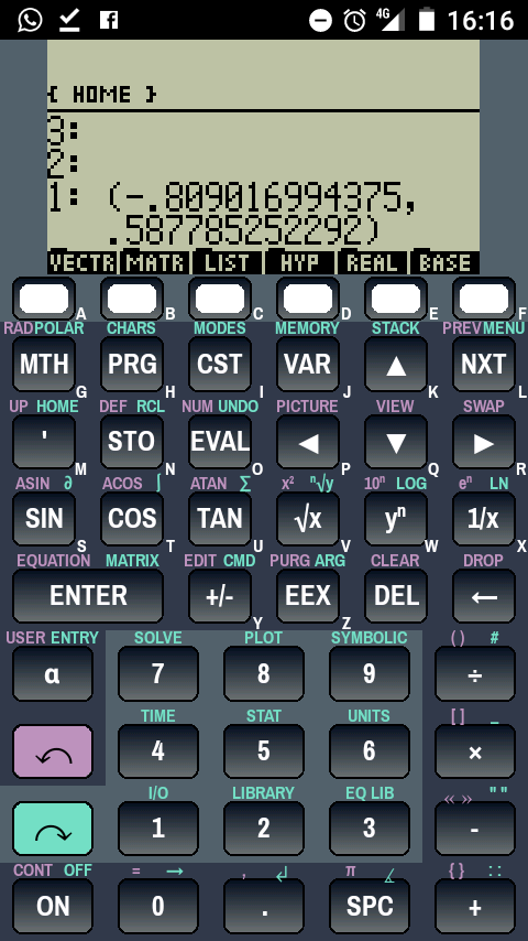

#3 Опубликовано: 15.10.2018 18:23:14
Calculators given the same answer. Here Droid 48 for Android

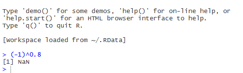

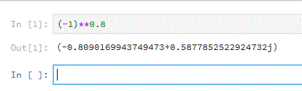

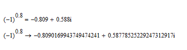

#5 Опубликовано: 16.10.2018 03:08:54
Mathcad
Python
R
