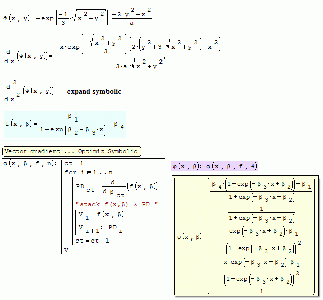

WroteOh, another thing. For me "variable" is that thing that can you can use second arg in diff. MapleV accept only names, but higher versions also take other things, like vector elements (V[i], for example) which is very very useful. And what I try actually is some kind of independence test. The best independence test that I know is, preciselly, diff(f,x)=0.

Hi Jean. Yes, you're rigth. What I must to wrote was diff(f,x) identically equals zero, i.e. f'(x)=0 for all x in Domain(f). This is the good definition for independence criteria, and, as you say, diff(f,x)=0 is for search critical points.
I found a new nightly build, http://en.smath.info/forum/yaf_postst7576_SMath-Studio-0-98-5990--26-May-2016.aspx, where my jacobian works, but ... with a but. Attached in pdf too.
