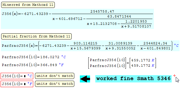

On the other hand, Smath unit system has changed from Smath 5346 to
Smath 6179 ... that freaks many of my projects.
