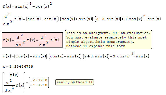

WroteAs I wrote, it is not big and not a kind it is impossible to live with it.
I am just reporting what I notice.
There is no use to evaluate the Mathcad style. On the other hand,
many direct expansion Mathcad style can't be copied for export.
Thus, the best is the algorithmic construction. On that point,
Smath is fully competent ... look @ the "Colibri" attached.
Spline De Boor [Colibri].sm (34 КиБ) скачан 73 раз(а).

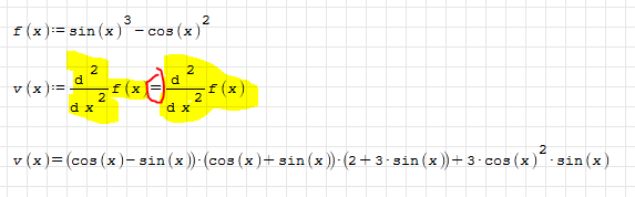

Thank you, [USERLINK]PDG[/USERLINK].
Bug confirmed. Will look at it later.

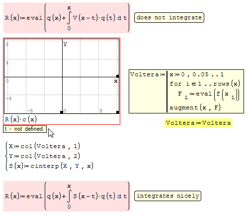

#11 Опубликовано: 18.06.2018 00:32:23
Wrote... this is another style of parametric solution.
... a much different style of transit.
At that times my brain diluted on that one !
Takes quite a while before "t_not defined"
Integrate Voltera IntEQUATION.sm (28 КиБ) скачан 77 раз(а).
