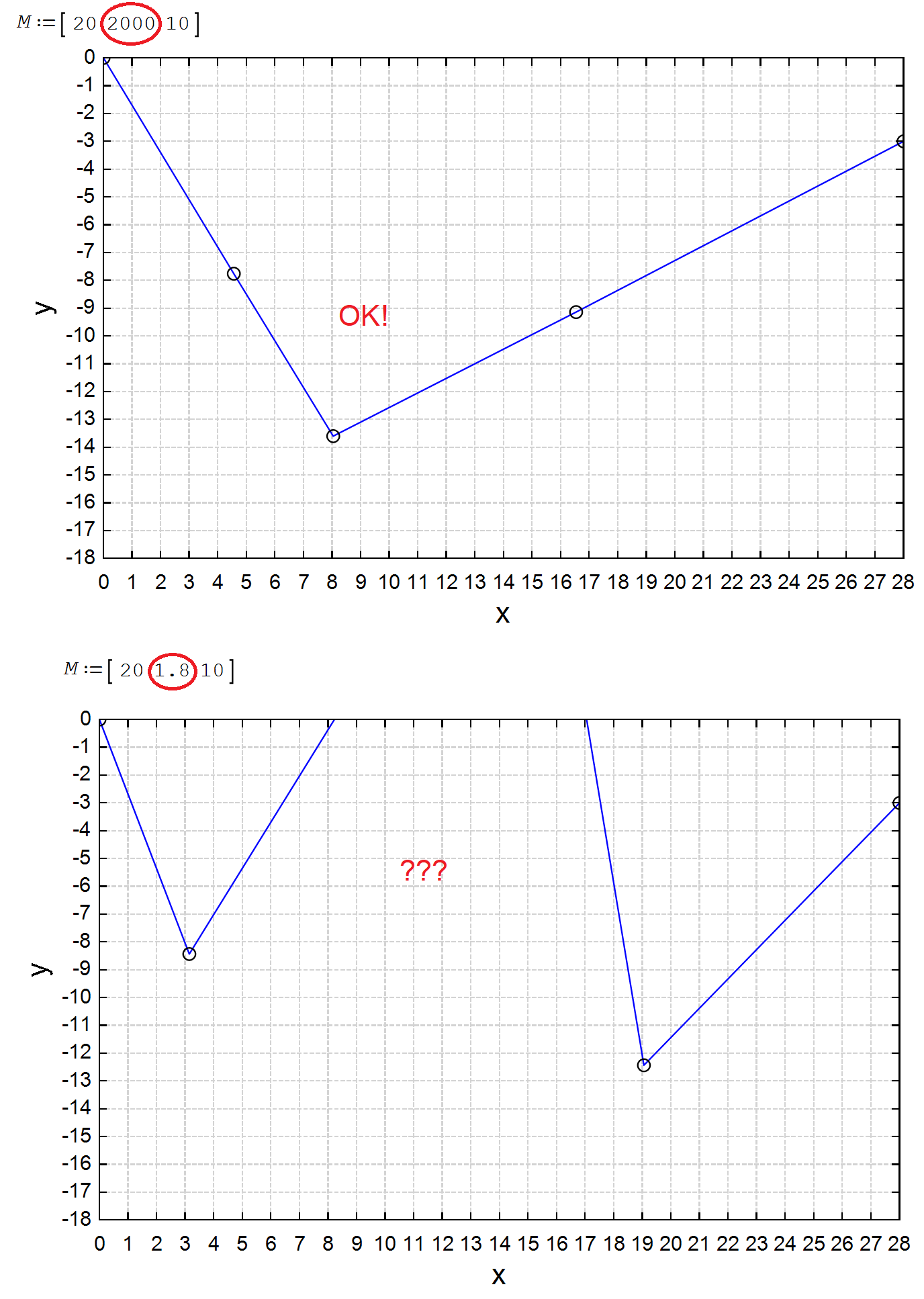

>Life would be much simpler of course if SMath had its own minimize or maximize function...
...with constrains.
#4 Опубликовано: 09.04.2024 14:52:23
Valery Ochkov
Valery Ochkov

Posted
Yes. In the loop where it checks for unacceptable y2 values I should have added the line, msg:="Unacceptable y2 values. Try different initial guesses".
Additionally, by changing lambda = lambda/2 to lambda = -lambda, it seems to work ok!
If you change the initial guess for y2 to 11.5 it also works ok.
Note: The method is very crude. It won't work for more than three weights, for example, without significant modification.
