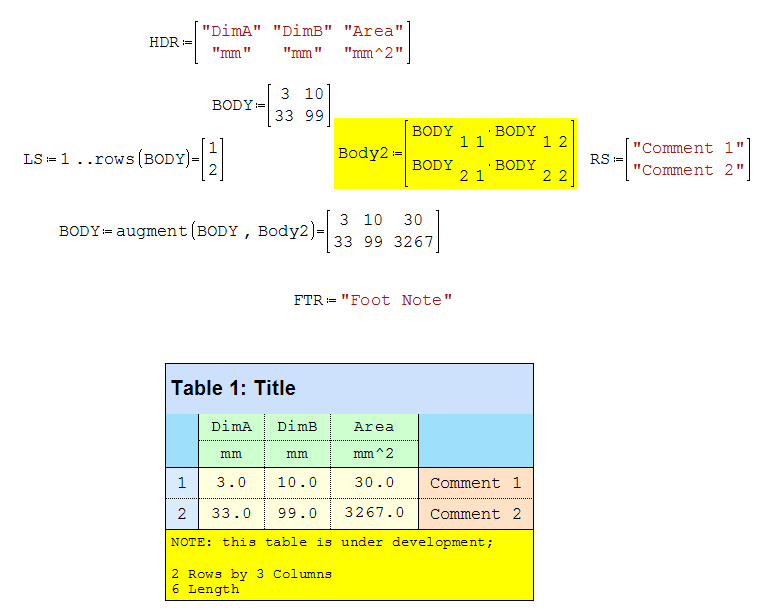

Hi All,
I'm trying to create an input table for a worksheet I'm working on.
It's probably a bit of a newbie question but I'm new to SMath (and matrices !) so any help would be appreciated.
I want to perform calculations on the data in matrix BODY.
I've done this in BODY2 as a workaround but I'd like to find a way of doing it so I don't have to edit BODY2 everytime I add or delete a row.
Any help / guidance would be appreciated
Peter

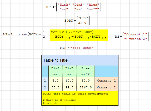

Hello Peter,
You can use a simple loop, like this:
TableRegion_Test.sm (10,15 КиБ) скачан 1155 раз(а).
![2017-06-07 12_15_37-SMath Studio - [TableRegion_Test.sm_].png](/ru-RU/files/Download/QTAqhE/2017-06-07-12_15_37-SMath-Studio---[TableRegion_Test.sm_].png)
