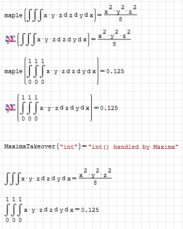

Hello, is it yet possible to do double or triple numeric integrals? Is see much older posts indicating it is not possible, but wondered if in the intervening 10+ years, this has been developed. I was not able to find a plugin that address this. Attached is an example of the type of calculation I am trying to do:
TripleIntegralExample.pdf (102,88 КиБ) скачан 1021 раз(а).
#2 Опубликовано: 01.10.2024 09:23:50
Hi Jon. I'm pretty sure that in some previous version SMath can deal with multiple integrals. Now you can use maple or maxima plugins.
triple_int.sm (8,47 КиБ) скачан 1631 раз(а).

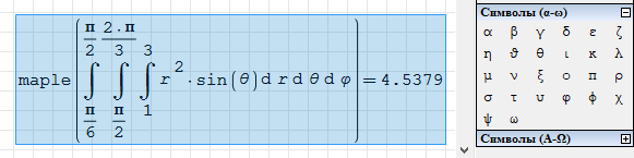

Do you know why Maple fails in this example? The Maxima result is correct.
#4 Опубликовано: 10.10.2024 21:35:07
Try another symbol for phi (φ).
The thing is that Maple 6 doesn't support Unicode symbols. That is why only one type of phi symbol was chosen.
They say there is such a symbol. I'll see why I couldn't use it.
Links:
1. https://www.maplesoft.com/support/help/maple/view.aspx?path=Greek
ioan92 10.10.2024 22:02:00
#5 Опубликовано: 10.10.2024 22:10:05
MapleTools plugin has been updated and is available in the extension manager.
So now you can use ϑ (vartheta) and ϕ (varphi).
