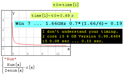

My computing times for the last block in your sheet are
2 core i5 6 GB Version 0.98.6484 i5 0.08 sec. 0.15 sec.
4 core i7 2700K 4GB Version 0.98.6580 0.08 sec. 0.19 sec.
4 core i7 Notebook 0.03 sec. 0.09 sec but only after storing and reloading
all on Win10 64 bit using SSD for programs
Seems that the newest beta version has introduced some speed improvements? Appearently no multiprocessing takes place. May be it needs a function parallelprocessing to be used in Monte Carlo Variation as example.

Not clear about your timing. I understand that you mean
2 core i5 6 GBVersion 0.98.6484i5 0.08 sec ... vs 1 core 0.15 sec
Calculations aren't linear wrt GHz
As it looks the 4 core is not much faster
True: Andrey mentioned some speed improvement [from recollection].
If true that 2 core i5 6 GBVersion runs 0.08 sec compared to 1 core 0.15 sec
that's most interesting [assuming Win 10] for an eventual purchase.
I downloaded 6484 on my old XP Pro ... opened 2 work sheets = 2 scrapped *.sm
Could not recuperate/rescue.

Thanks,
I upgraded to 8 GB with the old 4 core i7 on my PC and got
0.08 for Denom (x)*c(x) and 0.12 sec for Num(x)*c(x).
This does fit more into the expectations.
However as you stated multiple cores are propably not exploited, the difference in time may be attributed to the CPU frequency (but not completely since the newer i7 on the notebook is still faster having less GHz).
